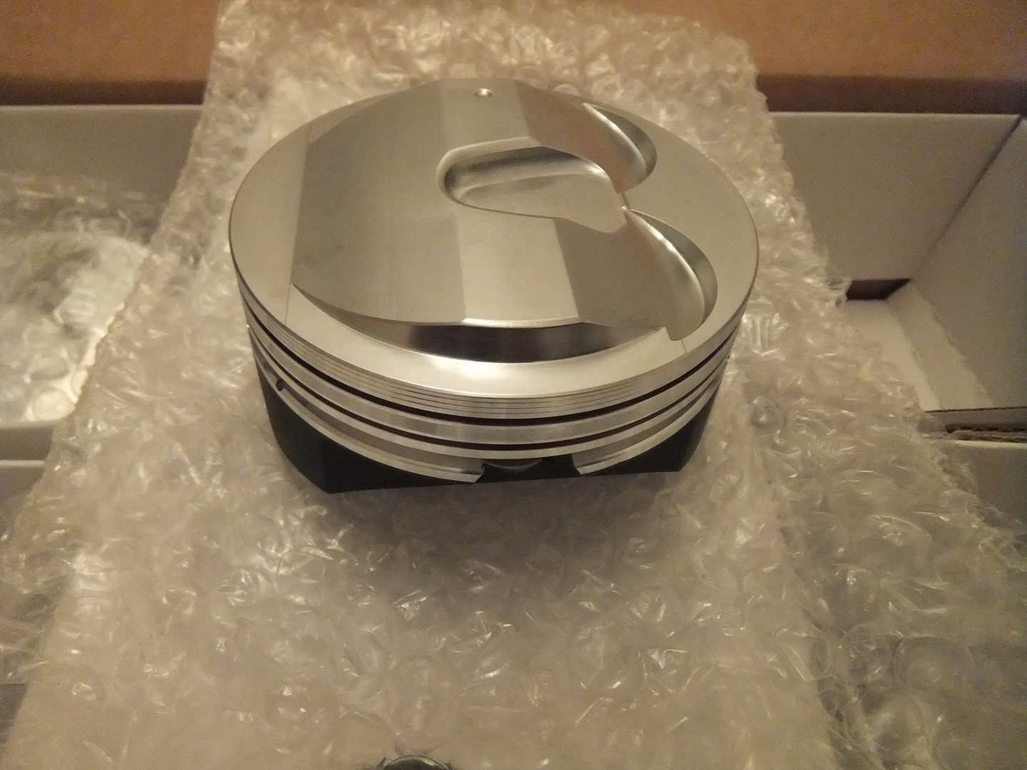

Here is a DI piston and you can see how complex this design is compared to a port injected flat top piston to see just how critical the burn pattern and quench areas are:

The piston you displayed is not a Ford Ecoboost factory piston. What piston product is that culled from?
The Ecoboost powerplants have never employed Superchargers, and to generically state "DI engines" in a general sense, I think is perhaps glossing over, and broadly labeling all DI engines as being related to specific perceived problematic issues to the Ecoboost platform individually.
