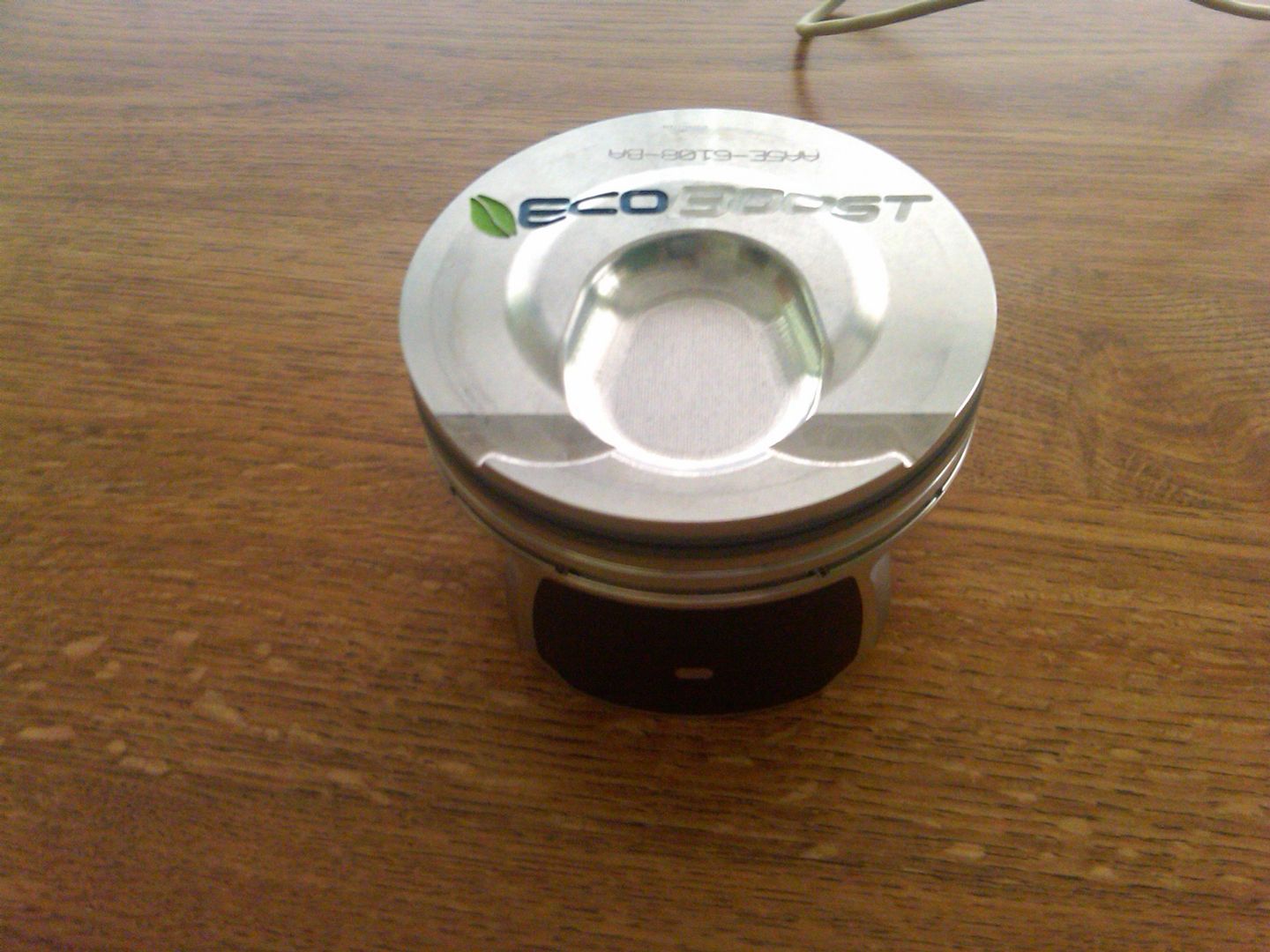

The picture I showed of the piston is pour forged version. Here is the stock EB piston:
Not much difference in the top design.

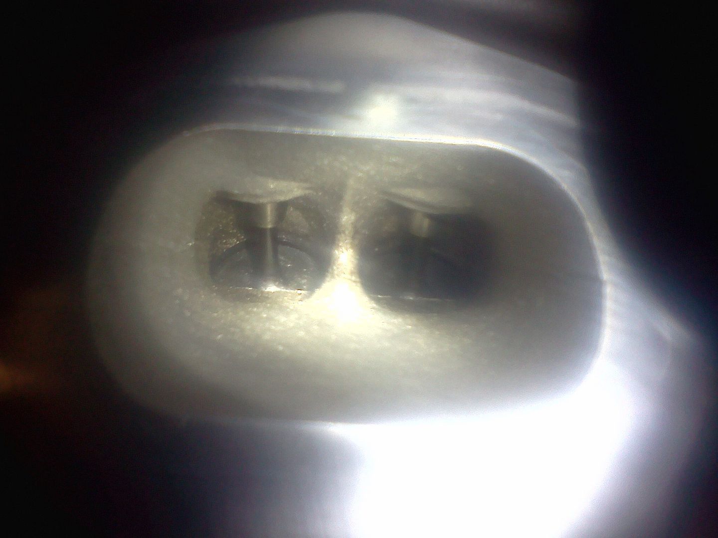

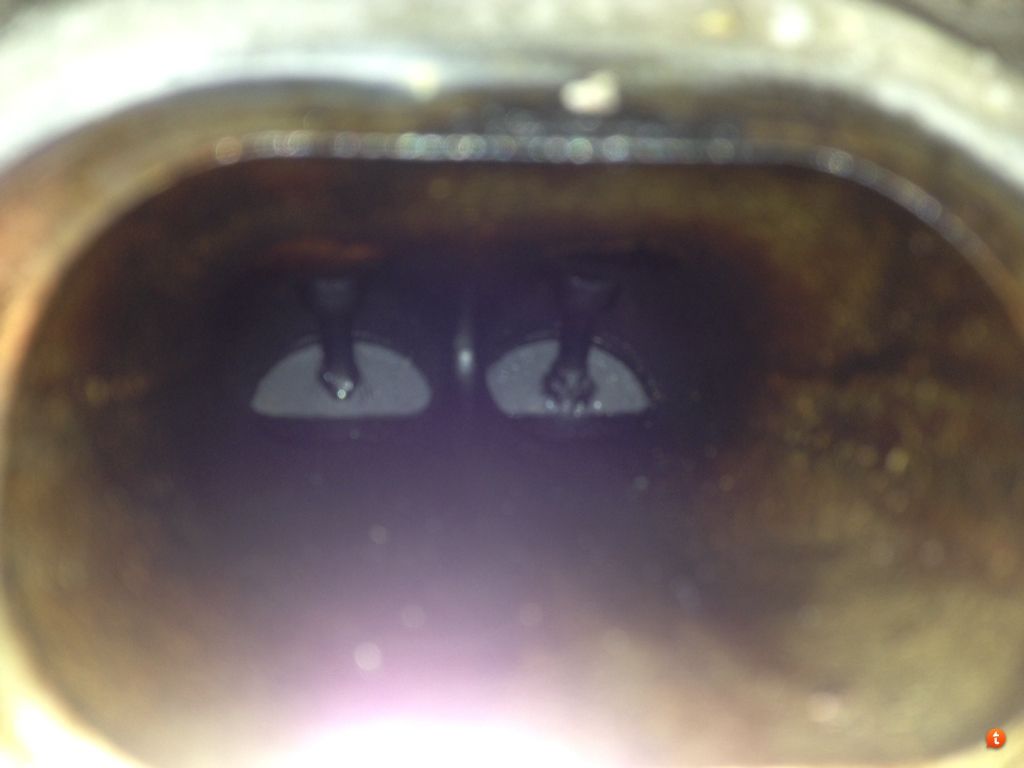

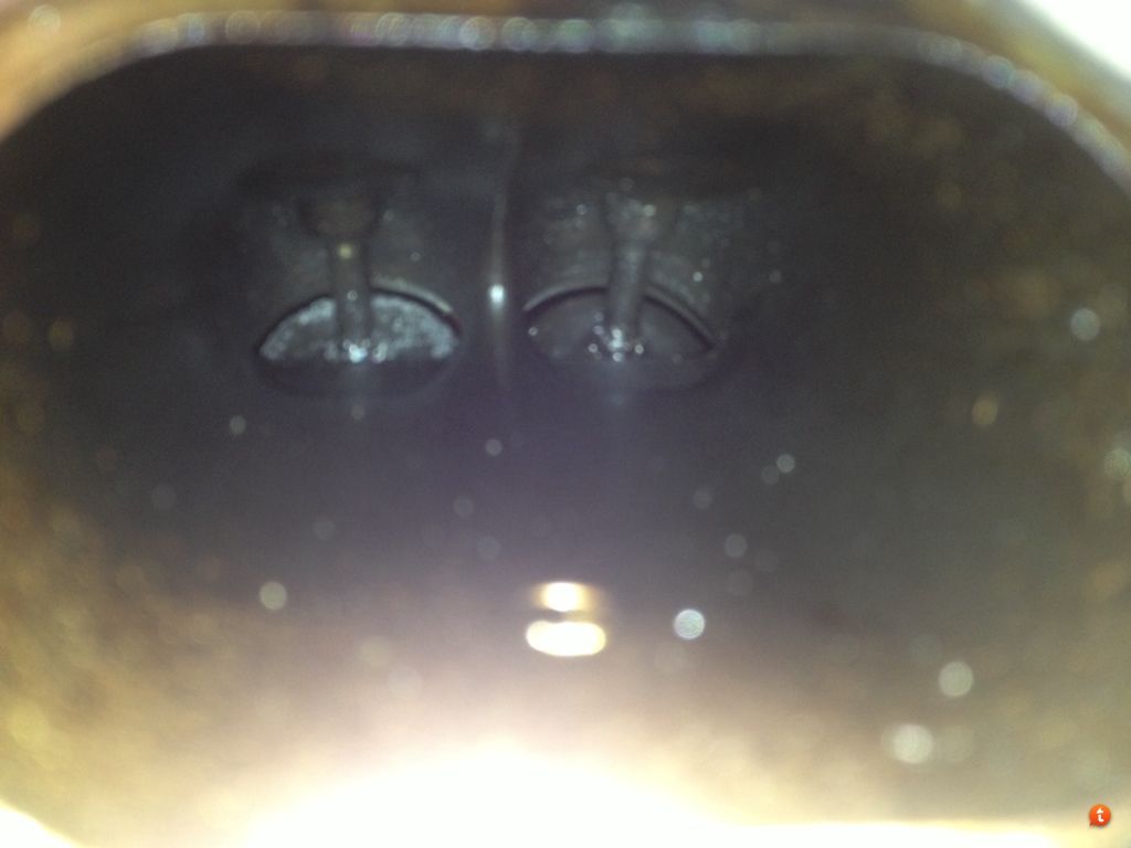

And more ecoboost specific pictures:
Each above is a different EB engine with as little as 30k miles, and the most was at 70k miles. Then after manual cleaning:

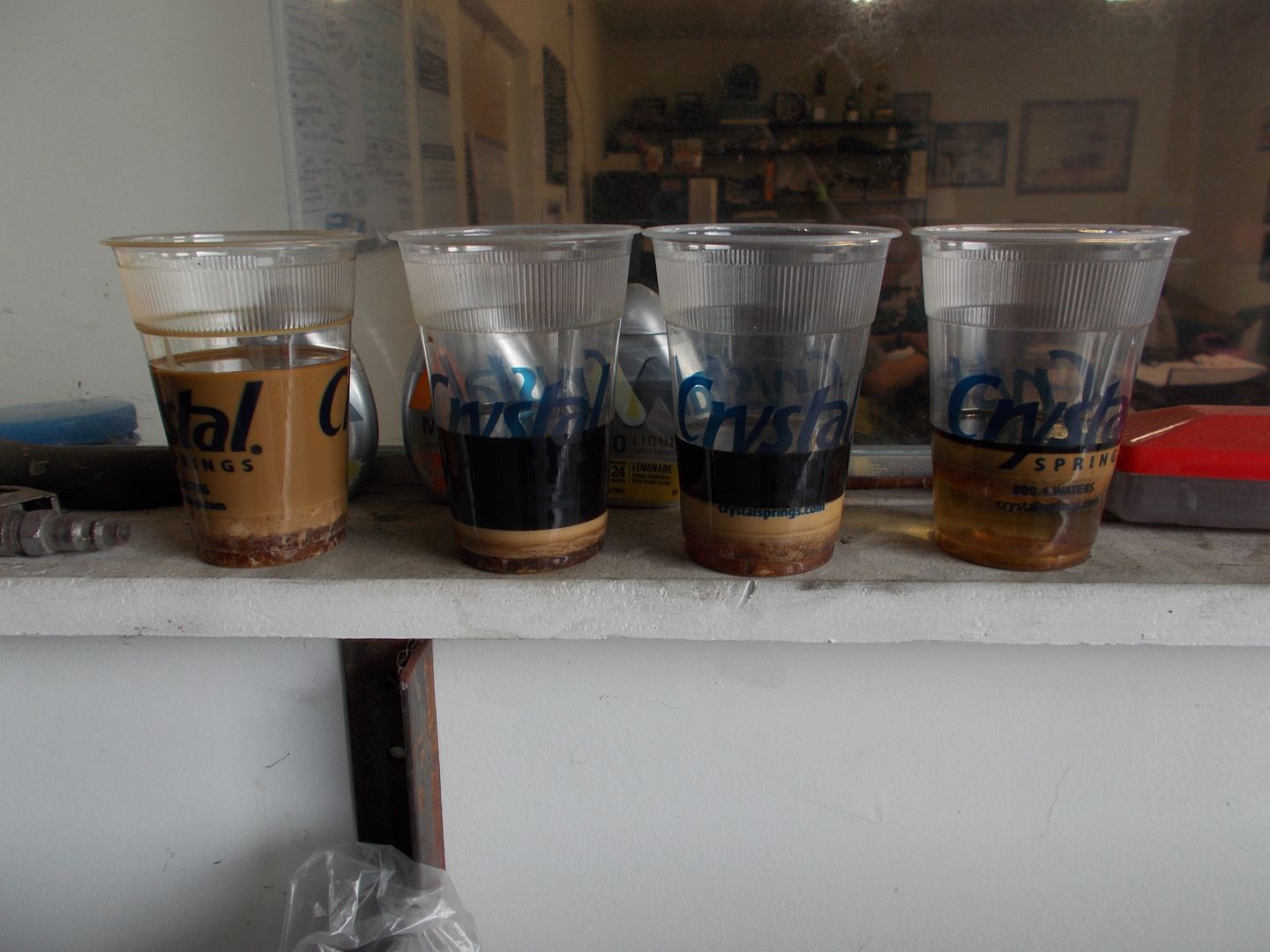

From the shop EB truck showing as the liquids separate:

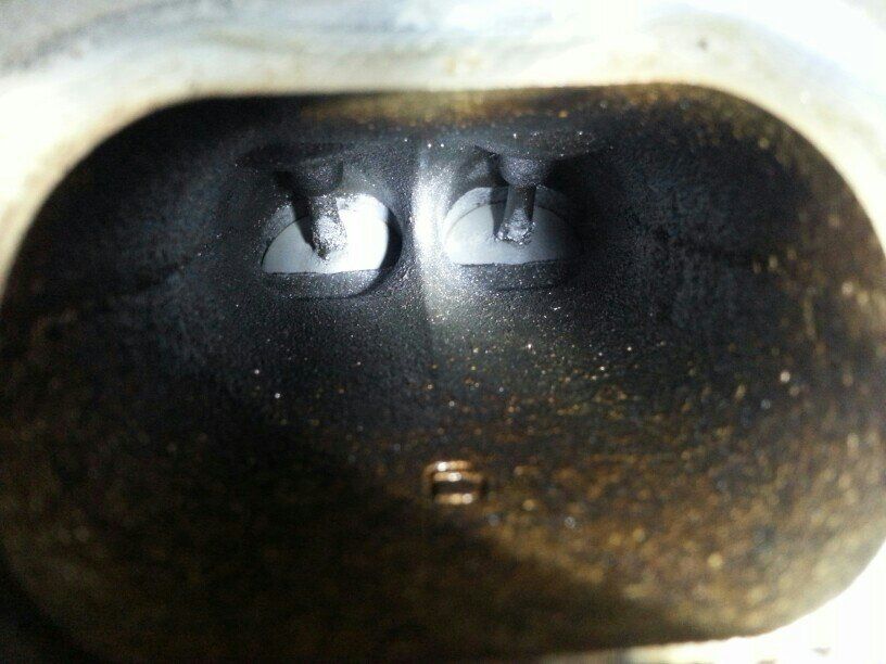

Pulled a CAC today to inspect and clean:
This is not a Flex or Taurus, but a 2013 F150....and it shows oil/gunk in both the inlet and the outlet tubes, so a good deal has been ingested.

Not sure on the miles...but installed the RX system app 1000 miles ago so there was no water as usual, and the can has been catching a ton of the gunk mix, so only oil was left in the CAC. Putting on a new aftermarket intercooler so will track this to confirm the RX keeps all oil from it.  We will get the owner to come back later to do a manual intake valve cleaning and document it as well.
We did before dyno and will do after to see what difference the intake valve cleaning does.

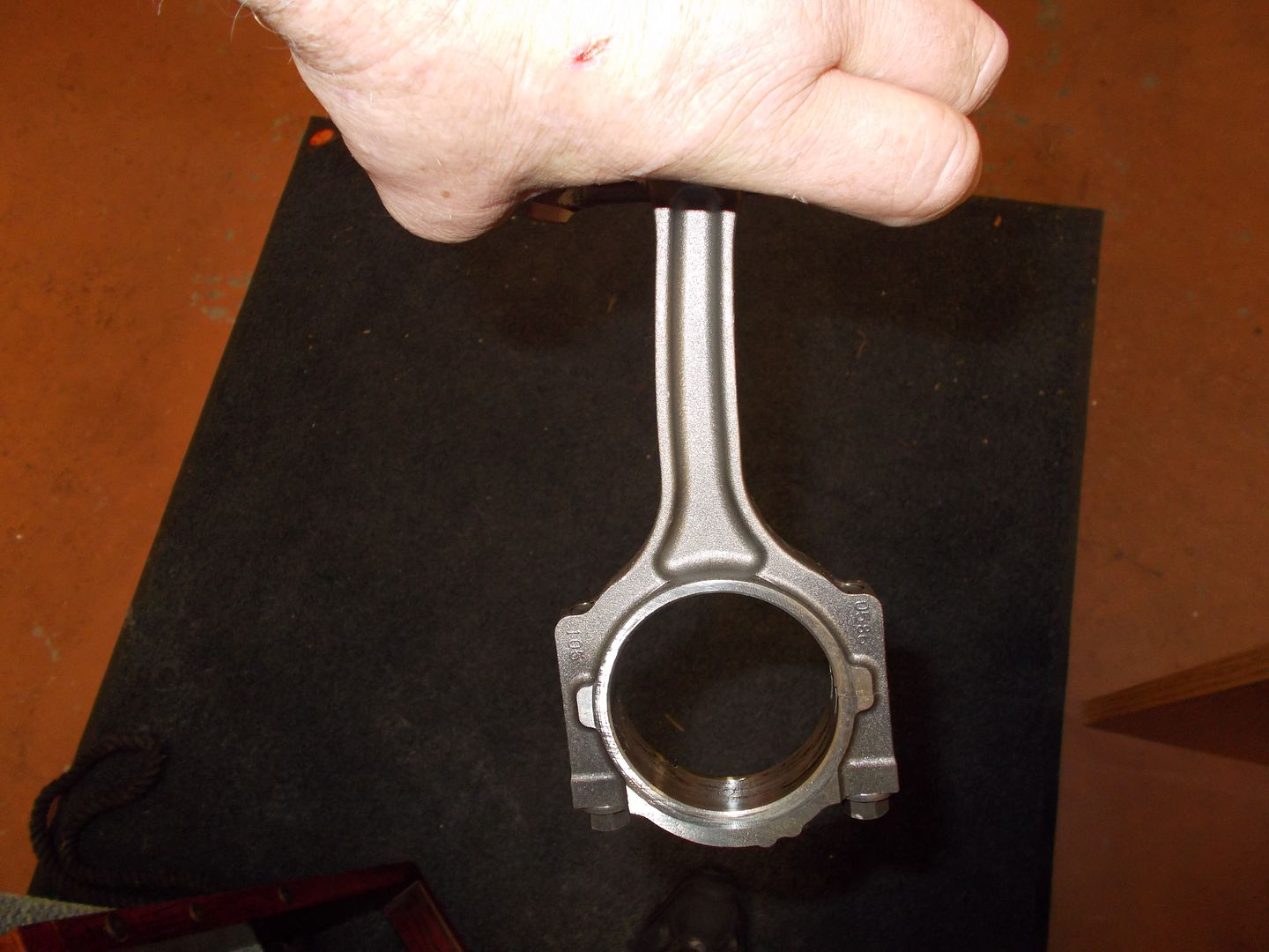

Also, had a hydro lock engine we tore down yesterday......looked fine from the top except some slight scouring on the cylinder wall, but when we pulled the pistons here is what we found:
Ingested a slug of water and had a misfire...compression test showed low but boroscope all looked good. dropped engine out and removed heads, still looked good except a few score marks.  Found pieces in the pan so popped pistons out and bingo. But it still ran half way decent and NO knocks or noise.
