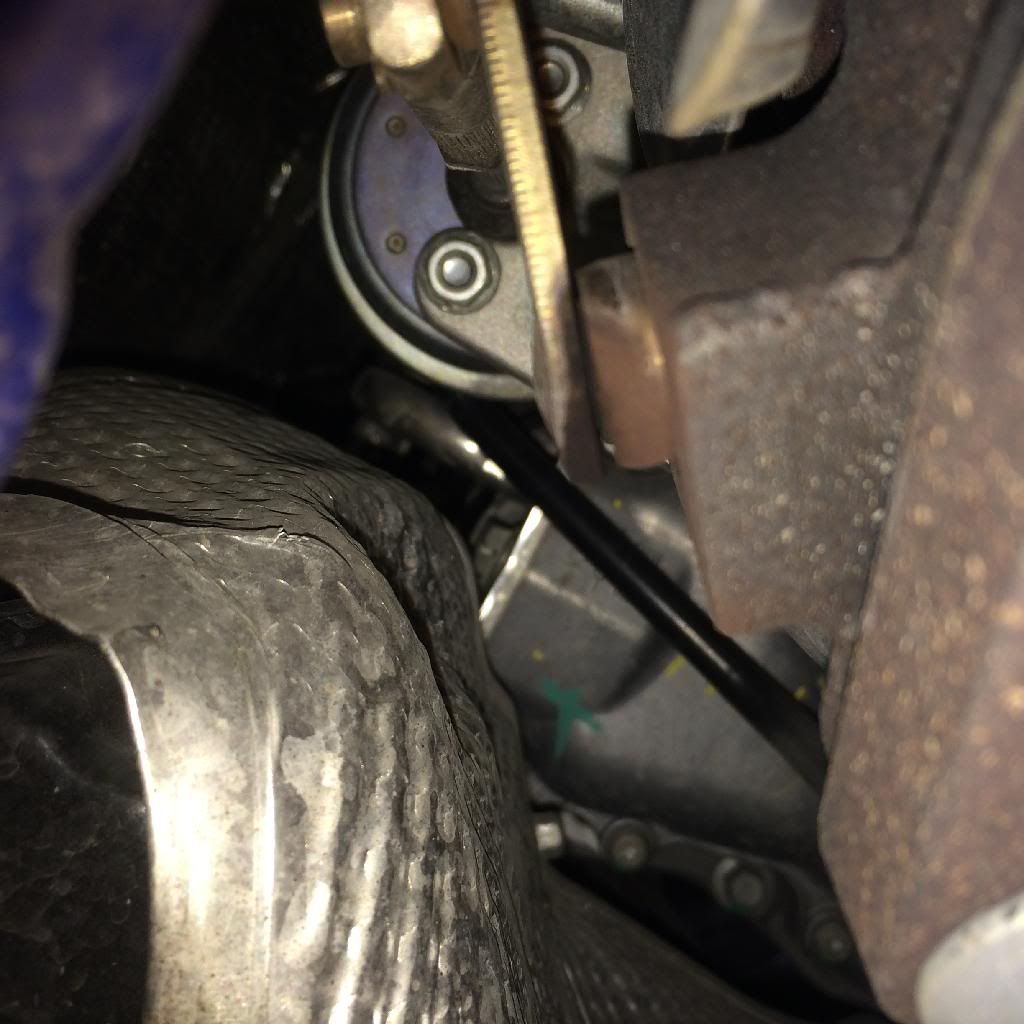

I thoguht maybe this bolt with my finger on it since it seemed to be at the top of the PTU, but I think it hold down the water cooler line going in ?

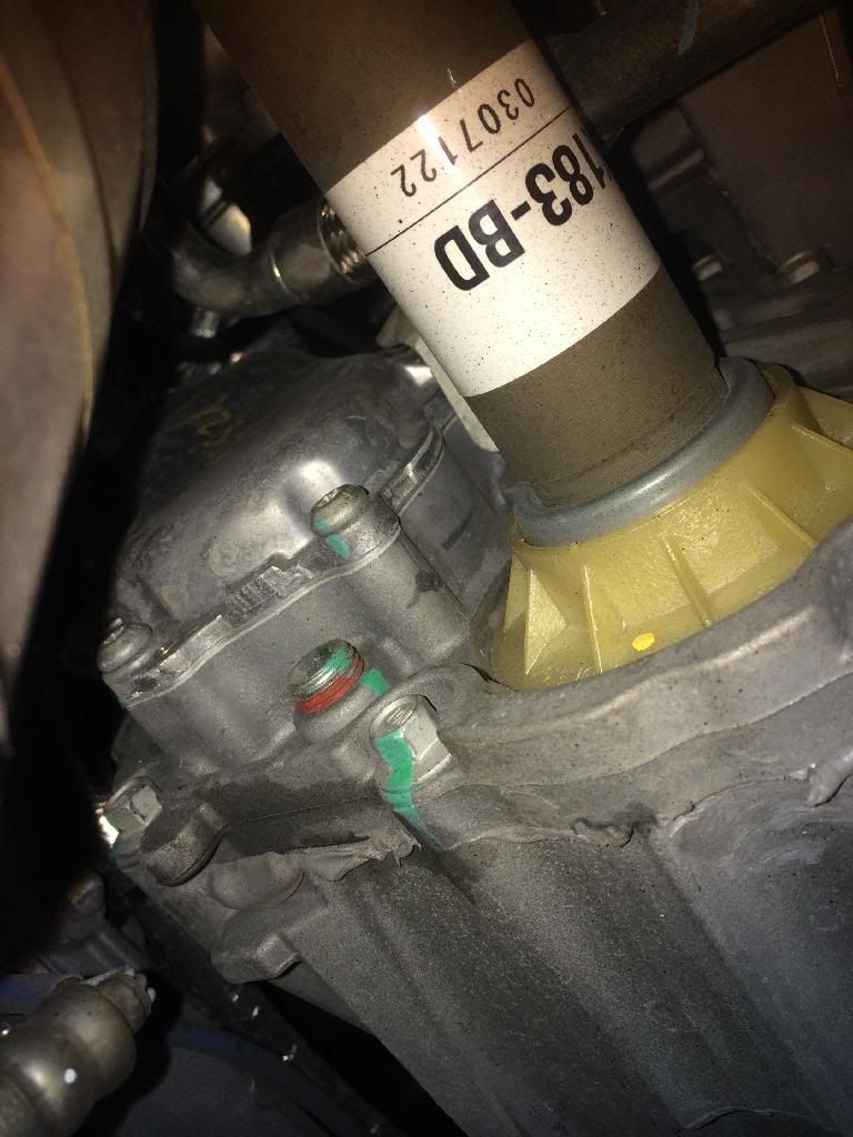

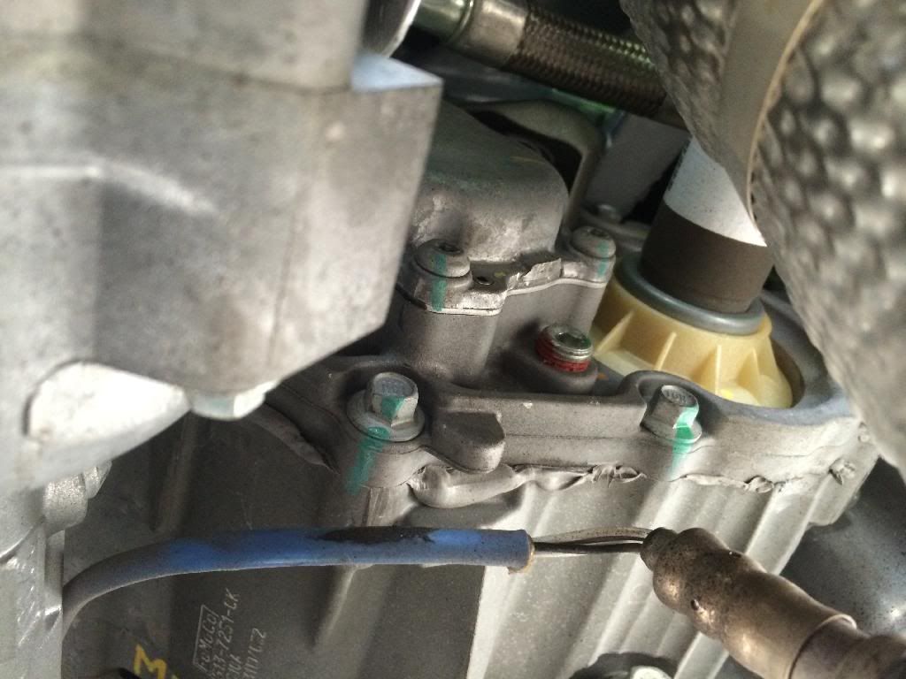

I believe this is my drain with the red sealant. I don't know if this is a 2013 set up, or a PP set up, or a 2013 PP set up !?

Can you see what is on the top side of the unit?
2012 Pearl White CTS-V Stock
68_GT
Quote from: ShoBoat on April 26, 2014, 12:42:56 PM
no way it's buried.

    Its the plug with the orange sealant on it.  A 3/8 rachet will fit right in to loosen/tighten it.
