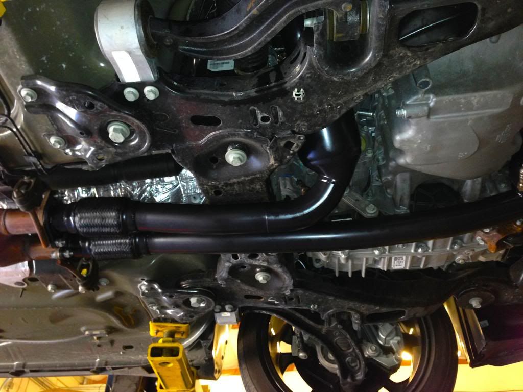

Yep... Love the ceramic appearance.... Here's my PPE DPs installed...
And almost anything is an improvement over stock... Here's what came off..
It's easy to see why the flow is improved... Compare stock to my uninstalled DPs...
Quote from: BiGMaC on August 21, 2015, 09:28:03 PM
Looks great Tom...I sure do like the look of those black ones. Man why didn't I go with that color...LOL...no offense Mike, just having fun
Rich
I went black with black... If I had ingot silver I'd likely have silver ones.... Still great looking  :beer2:
Objects of envy ... esp. for us Edge folks :D  Now that we have a 2.0 AND a 2.7 TT offering, maybe the market will take note!
