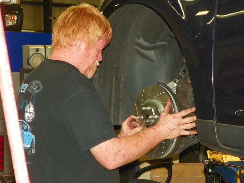

PowerStop had a complete proformance upgrade brake kit for 2010-12 Taurus's/SHO's from AutoAnything. http://http://www.autoanything.com/b...A5870A0A0.aspx My dealer installed them (Mike is my normial mechanic)
for $125.00 That's all 4wheels. That include drill/slotted disk and carbon/ceramic pads.Was $410.00, plus 10% off AutoAnything,and$40.00 PowerStop rebate for a total of $329.00 GREAT DEAL!!!!!
[/URL][/img]
