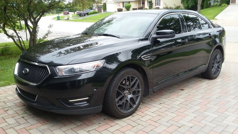

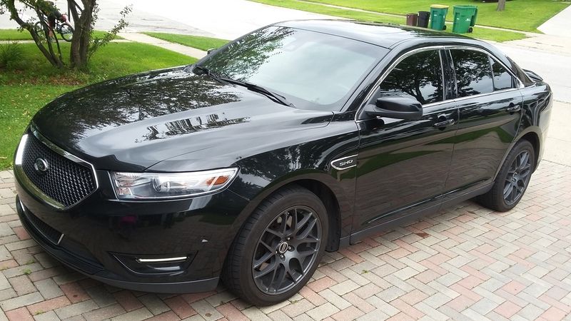

SHOgun77
SHOgun77
Yep, they seem to work like a charm! And thankssss!!!. In a week or two I will get em aligned just to make sure everything is cool
sholxgt
Looking good!
If you are going to lower it, I suggest holding off on the alignment until you have the springs installed.
