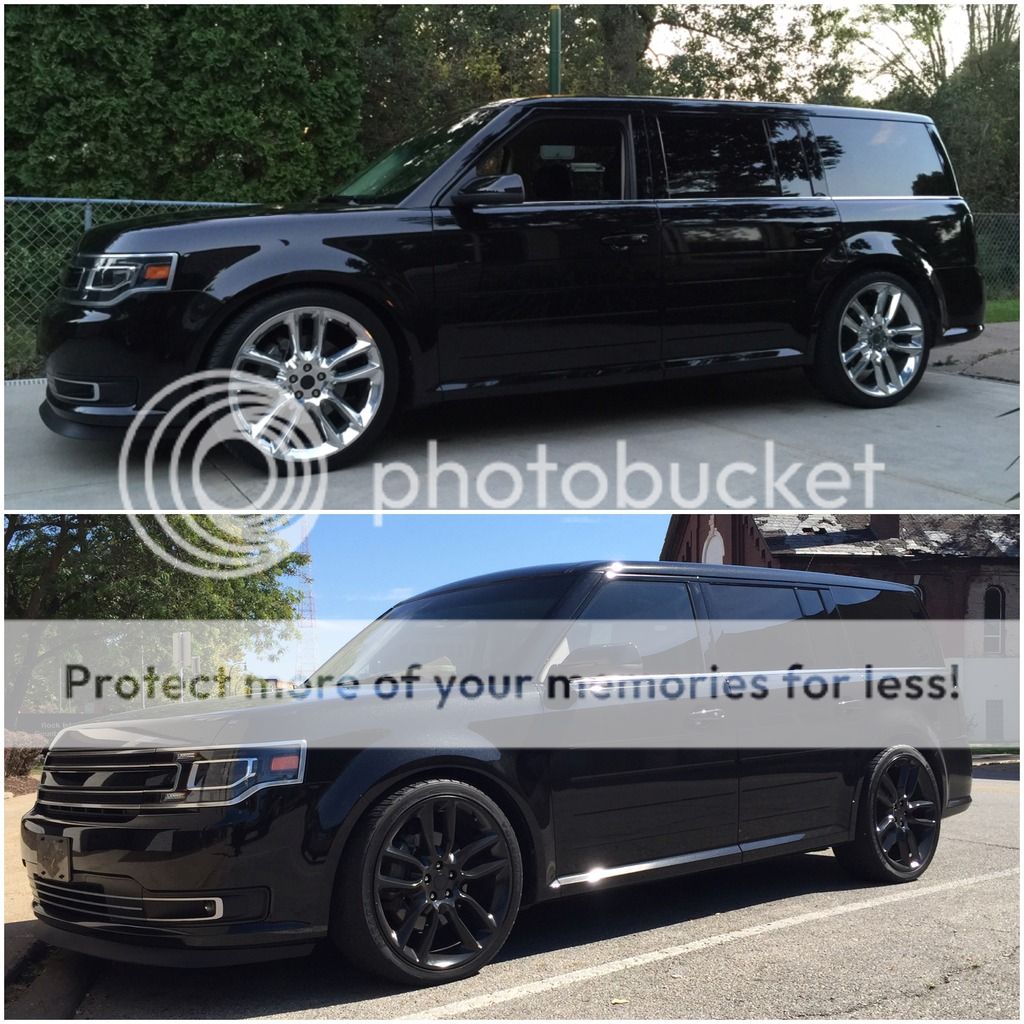

I am running the 10-11 MKX 22's on my flex right now.  They should totally fit, however.....   Keep in mind that they are not a lightweight wheel. They are forged though. They look great polished or black too.  Too bad you weren't closer, I'd let ya try em or buy em. I'd post a pic but they are on a Flex and that's no help. Good luck!

Sabtaj1
This is a shot of them polished, lower pic is of them plasti dipped black with glossifier dip as well.
Now this picture is how they would look powdercoated gloss black.
Hope this helps.

Definitely looks good on the flex especially in black.

Those defiantly look sweet!!
I love the black especially but considering my car is white I'm not sure if they will look good. Probably would have to go with polished.
Did you say you were selling them?
