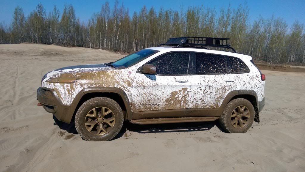

Thanks and your welcome. One thing this car has that my SHO with PP didn't have is the adaptive cruise, man what an awesome invention. I do miss the cooled seats though, well that and the neck breaking acceleration.
2013 Tuxedo Black SHO PP
I wouldn't sweat the loss. That Jeep is friggin sweet!

What happened to the OEM 20" wheels"  Those 18's in the pictures doesn't do the car any justice!
I don't get why the Cherokee Trailhawk model gets shafted on the cooled seats and HIDs.  You can get them on the Limited.  Doesn't make sense!
