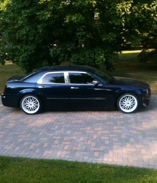

Here are my 20x9 30off-set with 275x40x20' Fits good

That's a good example of success.
Pokes in the front though, right?
