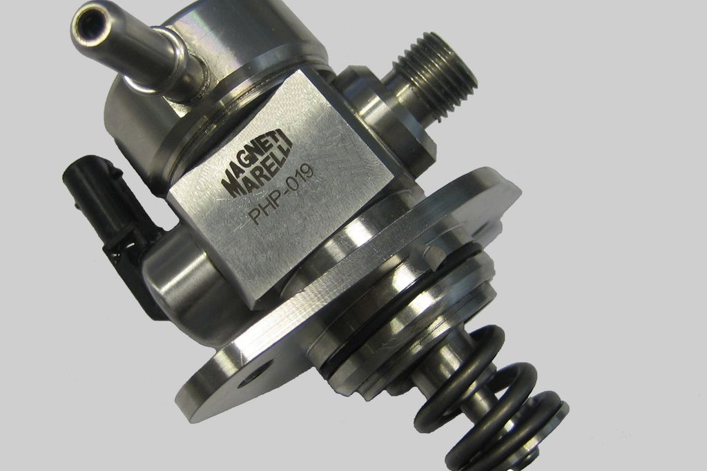

This  is a supposed drop in replacement for the 2.0EB for the ST made by Magneti Marelli  FoMoCoSHO thinks the 3.5 EB and 2.0EB in the ST use the same Bosch HPFP
This HPFP is also used in some Chrysler / Dodge engines and rebranded for GM under  the Delphi name .
Spec's are similar to the Bosch unit and somehow the ST guys are getting more out of this one .
Might be a worthless endeavor just trying to figure stuff out .
http://www.magnetimarelli.com/business_areas/powertrain/gasoline-system-gdi/gdi-pump
Max operating pressure is basically the same as the stock pump FYI
Quote from: FoMoCoSHO on April 19, 2014, 11:05:04 PM
Quote from: SwampRat on April 19, 2014, 11:06:20 PM
Could it be because they only have 4 injectors to feed?
