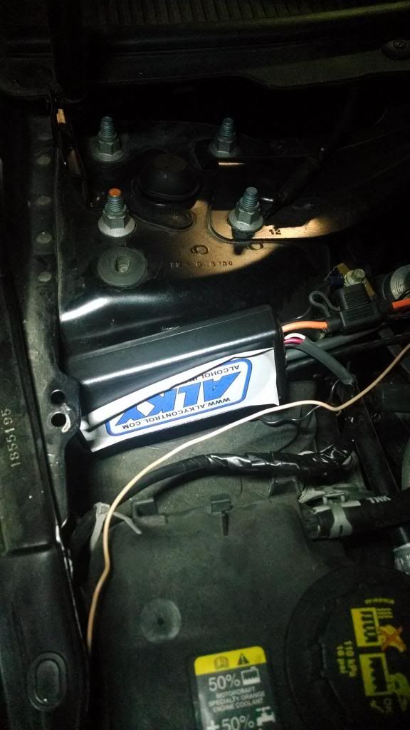

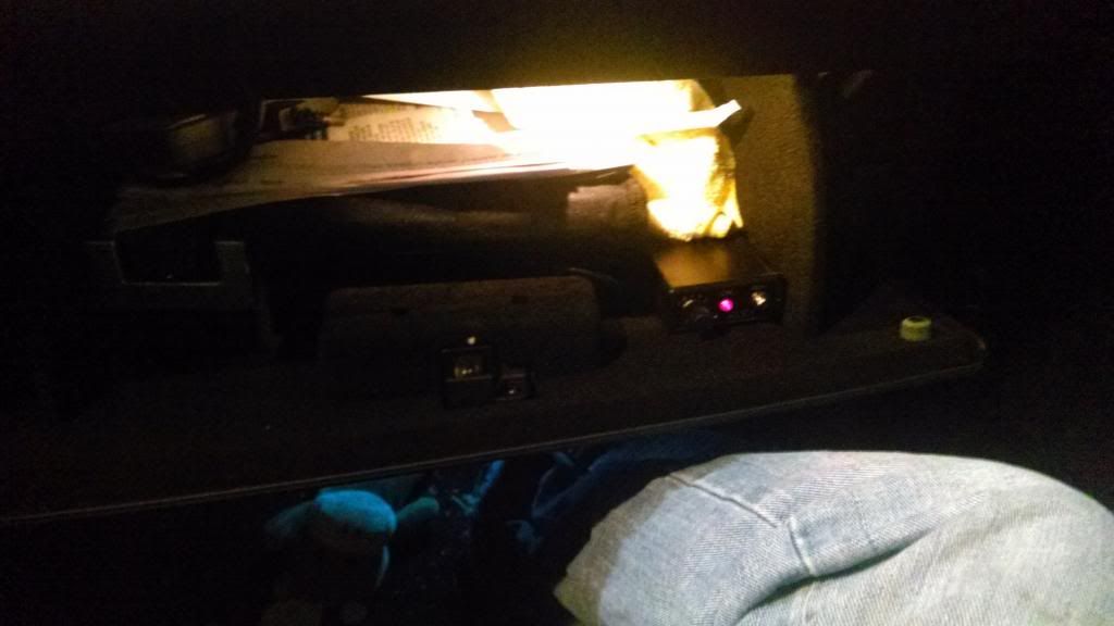

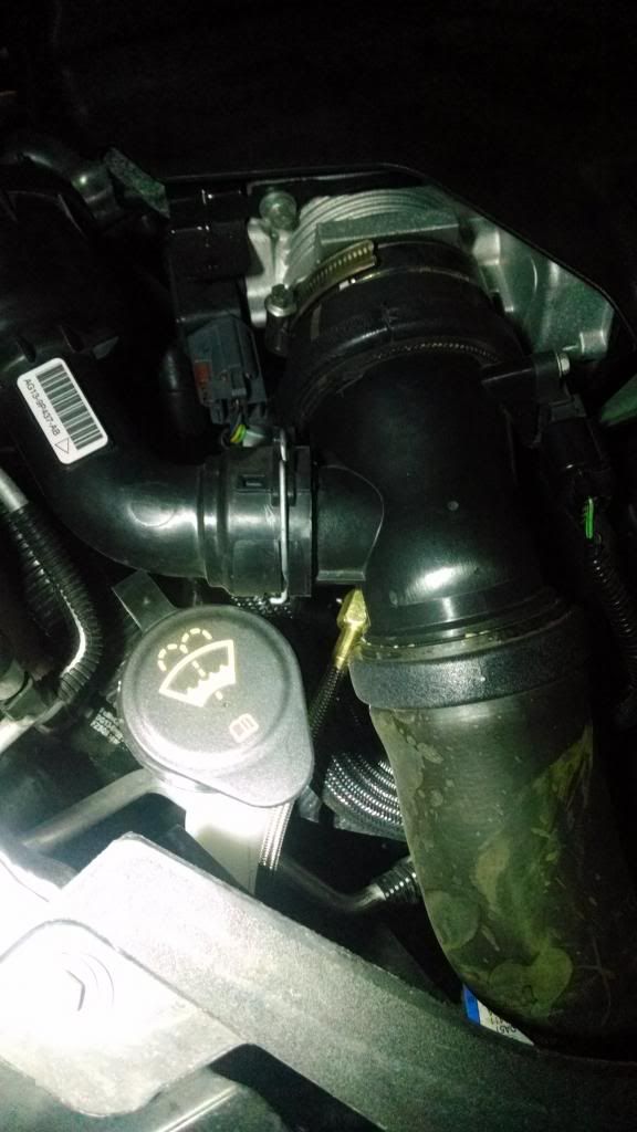

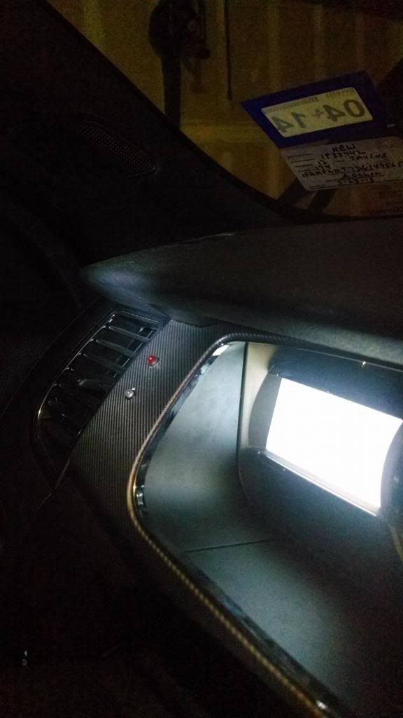

Cellphone pics but there not horrible. Kinda did my own thing on placement even though I read bpd's guide. I relocated the WW fluid to the trunk, just waiting on some male female adapters to arrive so I can make a harness to reach the pump/low level sensor. Also debating on relocating the battery to the trunk and using that space for my catch can setup. Still have a few more wire runs to electrical tape up (ran out).  Last shot is of my new windshield banner :)

Nice install. However I highly recommend moving the controller box out of the engine compartment it is not weather proof and may not be able to handle the heat of that environment.
I was wondering about that. I'll move it this weekend or shoot Julio an emailand ask his thoughts on it.
