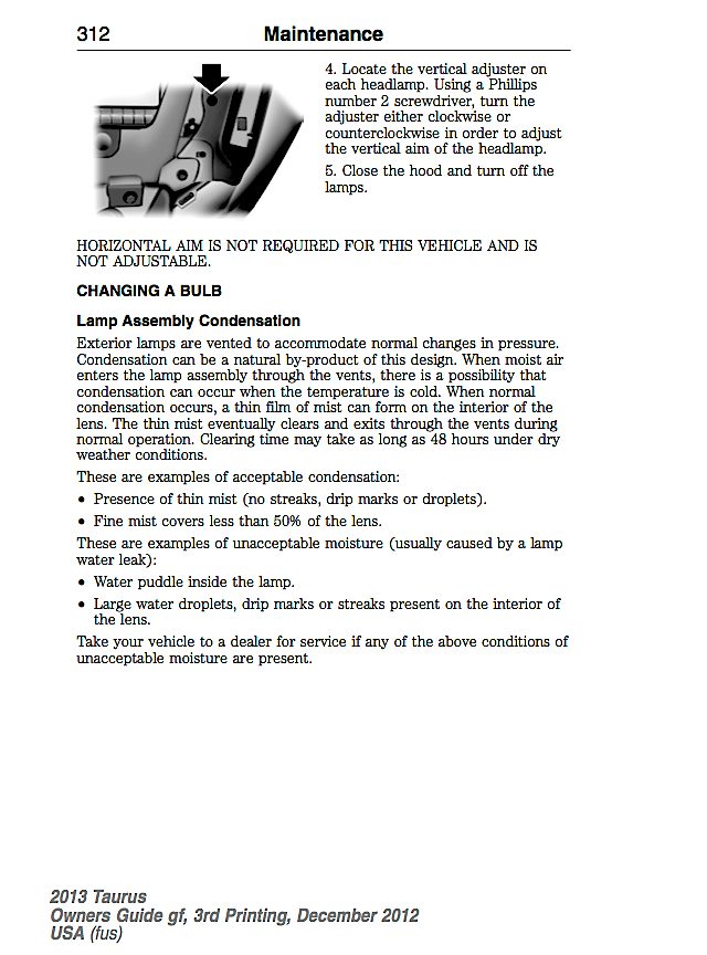

Seems to be a cold weather thing when it happens.  I have not had a problem, but can tell that there was condensation at one time.  I'd have the dealer look... Here's what the 2013 SHO manual says about it and what Ford considers unacceptable lamp assembly condensation.  Yours seem to fit the unacceptable description from your pic.

Thanks for that.  I'll see what it looks like once it warms up.  I feel like it's just a few little drops that froze, but we'll see

NP... Still it had to "puddle" to make the "drops"... your pic doesn't look like just fogging... I wouldn't hesitate to have the dealer look.

To me, a puddle is standing water.  My dealer seems pretty cool so I'll have them look at it when I go for my first oil change.  I also have the hood and trunk alignment issues, so I'll have a list for the !
