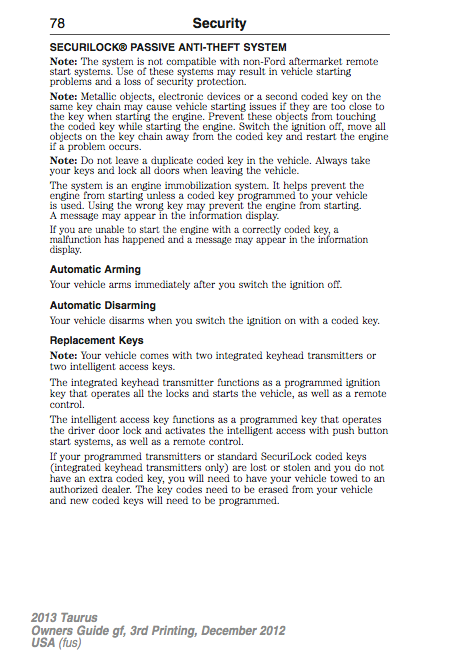

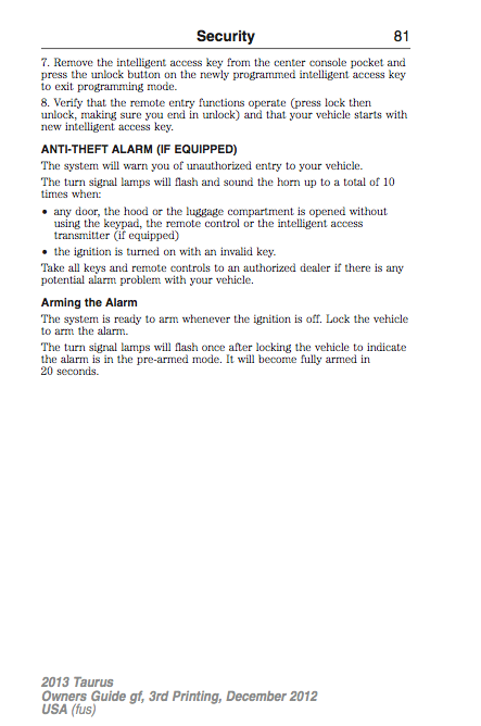

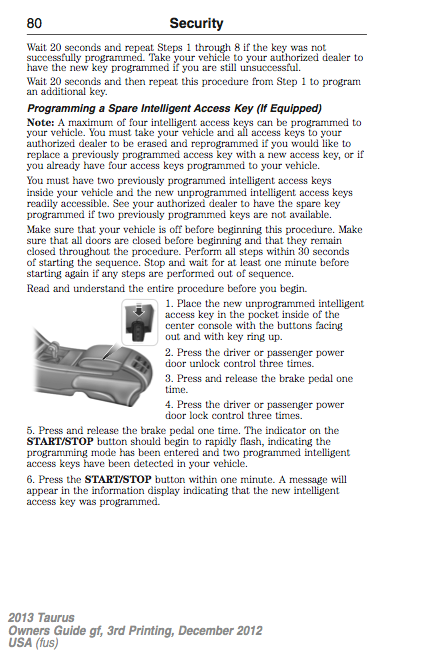

Here are the 3 pages from the third printing of the 2013 owner's manual... it's pretty easy.  You can't have more than 4 fobs (intelligent access keys Ford calls them) for any one car. Hope this helps you out.
Left click to enlarge the images
