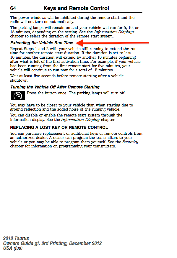

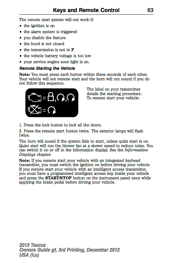

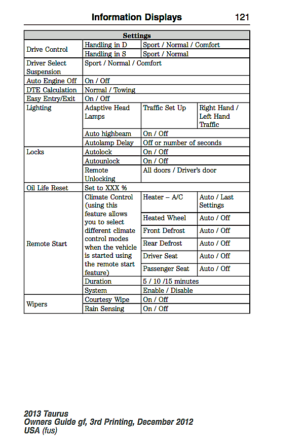

Here are links to the oficial Ford owners manuals as searchable pdf files so you can read for details by model. There is a way to double the time on the '13 by just hitting a button on the key fob (third image below), and for cold weather the heating can be programmed to turn on too rather than default to your last setting if desired (deice/defog, etc.):

Below are 3 pages that explain extending run time to at least 20 minutes. click them to enarge... See the red arrow on the last one The menu will come up in "settings" to the left of the speedo in a '13.
Unfortunately the dealer added option apparently doesn't work like the factory installed option... users of these systems will need to help out.

... If you use the fob to twice (step 1 in the imaged pages below on a '13) Ford factory system will run 20 minute (if it is at the default 10 minutes).... In the summer I set mine to 15 min for air conditioning. Don't know if the 15 will double, haven't tried that one.
