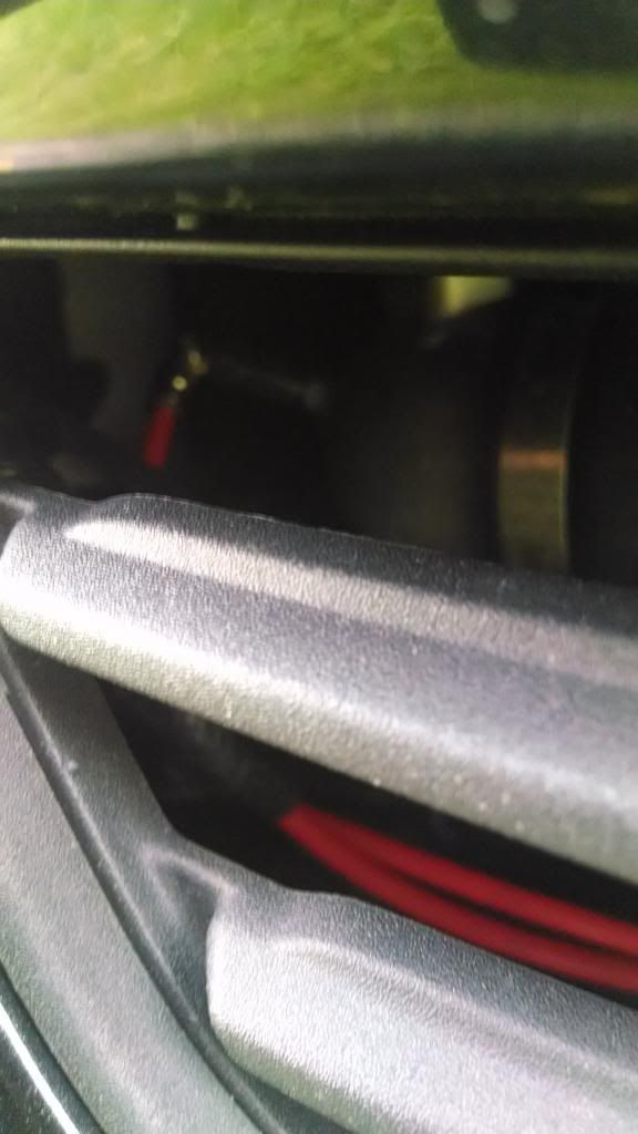

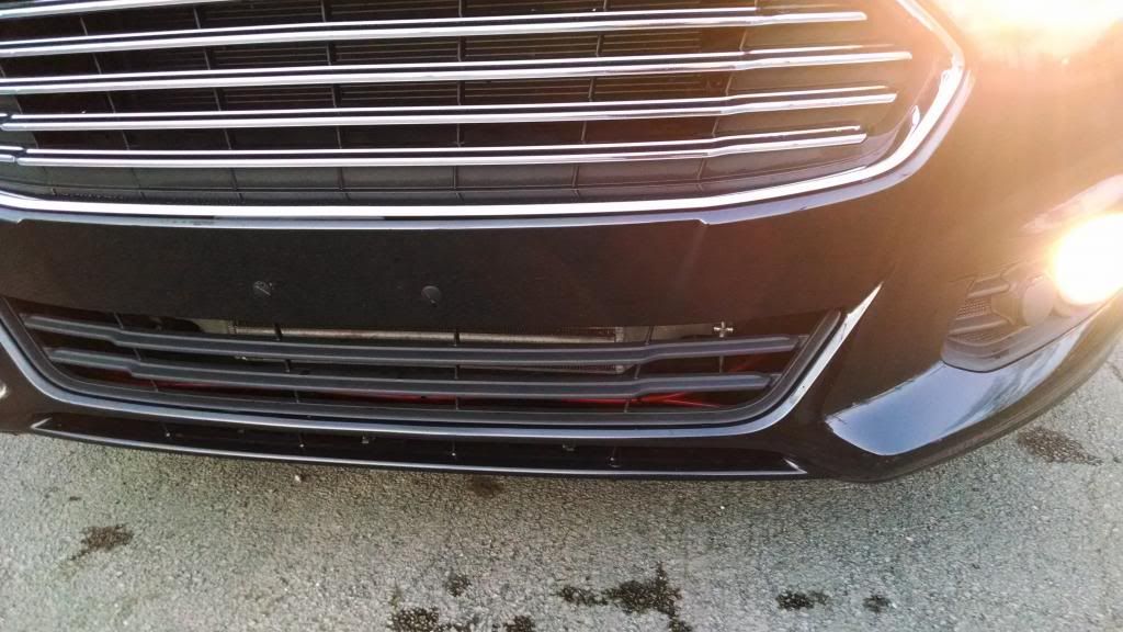

Well got the water meth kit installed last week.
The only problem was I was getting quench and the car was running like crap at high boost. Come to find out they put the 375ml/min nozzle as opposed to the 175ml/min nozzle that should be in it.. So sadly I had to pull the fuse for now until the nozzle gets changes and I have decided to order snow performances controller upgrade to the vc-100 so it's more progressive and not all on at 10psi.

Quote from: Josephm on May 06, 2014, 12:15:53 AM
Are you spraying the inter-cooler?
I'm spraying the cold side charge pipe just post intercooler. I had to mount the pump on the other side in the bumper and that's why you see the red piping in front of the ic.
