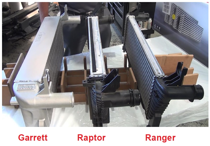

Doing more research and starting to wonder if this won't actually work.  Although Tasca lists the parts number are interchangeable..here is a pic of the stock Ranger IC (on the right):
This isn't what the inlet tube of the stock XSport looks like at all, not at all.  Different angles. So I wonder what is going on here...hmmm...
BTW, turns out there a few options out there for upgrade Ranger ICs. Just a few:
https://www.mountuneusa.com/1400-IC-AA-p/1400-ic-aa.htm
https://www.garrettmotion.com/racing-and-performance/performance-catalog/intercoolers/3-2l-ford-raptor-ranger-everest-mazda-bt50-performance-intercooler/
« Last Edit: July 24, 2020, 12:31:05 PM by Ecoboost_xsport »

Raptor Ranger intercooler? That one looks a bit better than stock and looks like it would fit. The Garrett looks like it would be a bit thick.
The Mountune dimensions look like it's only an inch thicker. Gearhead is designing one currently and will release it in late summer if it makes it to the market. Either way it looks like we may have sort of an upgrade.
