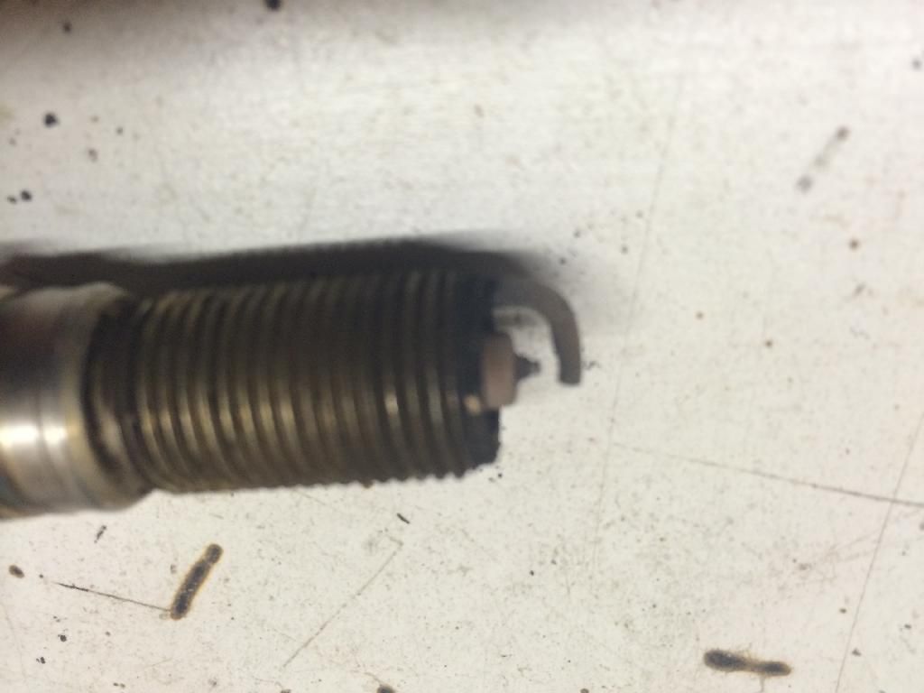

Quote from: Kolk1 on January 26, 2014, 07:03:11 PMHard to get a good pic, but this is probably one of the better plugs I took out. lol Also, I think I might of had a little bit of knock or something with the old plugs that was pulling timing or something. My boost gauge is showing im doing about 1-1.5lbs more boost now. lol
Quote from: mjhpadi on January 27, 2014, 02:13:08 AMSo now that you changed the plugs would you recommend using dielectric grease on the boots and plug connectors?
Quote from: QuickSilver on January 27, 2014, 11:43:39 AMIve owned dozens of turbo cars (like more than 50) and one constant Ive found that regardless of the make/model is that they 'eat plugs'. It seems to depend on the 'severity' of the tune and amount of boost. In my 2.2l Mopar track car if the plugs last 3K miles Im surprised Street car at 16PSI of boost or less, 15K miles is when I check/change them. 60K miles you went? Not sure if we should congratulate you or dunn you for not doing em sooner Were any of them loose or have combustion 'tracing' up the side of the body?
