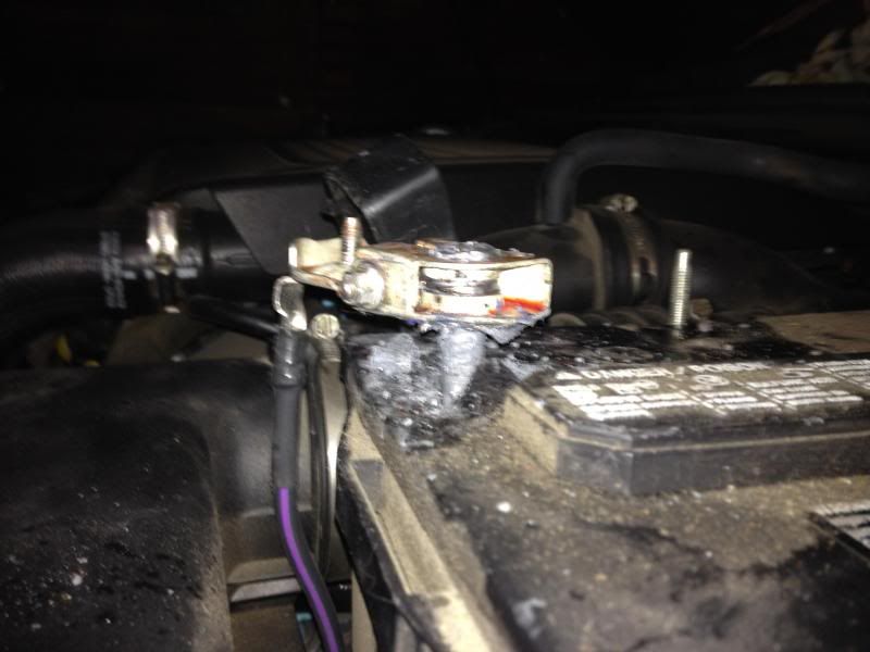

This thing is driving me nuts. The terminal will NOT separate from the damn post!
Here's a pic of the mess:
It spins freely around the post but it seems like the very top of the post has mushroomed or something and I can't pop it out. Any suggestions?

Take the nut off and use a screw driver as a wedge to spread the post clamp open.
qwiksilvertrav
Finally got it. Ugh what a pain in the butt! Nut was loosened all the way but that post was corroded to hell. Definitely could be the problem. Gonna head off and get a new battery now.

Put in the new battery and fired right up!!!! :) Thanks for all the help.
