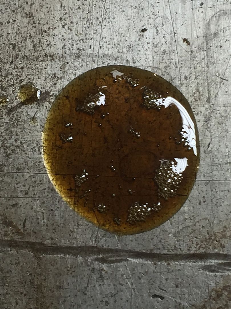

So after reading all the horror stories about PTU fluid and how bad it looks, I decided I should probably do mine since I have 85k miles on it. And I bought it with 32k, and shortly after did the Livernois stage 4 tune, and ive used to tow trailers a lot, and random stuff like that.
So in a nut shell, my fluid looked practically brand new.
I had the car up on a lift, Didnt remove anything, just reached up with a 3/8s ratchet, removed plug, used a Mityvac Fluid extractor and pulled out around 10oz (spilled some), and then refilled with Royal purple.
I did have some silver paste type residue on the fill plug, but that was about it.
I was expecting a huge pain in the ass, and black tar to come out of this thing. Looked pretty clean to my naked eye.
Good info Kolk... And good for you. This has started me wondering what is going on with the PTUs full of chocolate syrup if yours looks like that at 83K! There has to be something going on in the actual FMC build with some of the PTUs.
What is the build date on your SHO, Kolk?  There ARE a few other folks who have had little to no problems with the PTU fluid.  Like BiGMaC said, Ford must have slipped up and made a few good ones filled correctly from factory ;)

I had the PTU service performed by a local shop that does the BG Services. My Ford dealer refused to service the PTU.
At 60k miles, the fluid was black with small clumps that were a little larger than pepper flakes. The BG guys said they had never seen gear oil look so bad. There was almost 1/2" of material stuck to the magnetic plug. They flushed out twice.
Interesting that there are such wide reports of the status of the gear oil.

Kolk1
Mines an 11, besides that I'm not sure of the date, I'll check tomorrow.
Mine did have some silver paste on the plug, but maybe 1/8th inch at most. But that's it's job, and the fluid looked pretty good.
