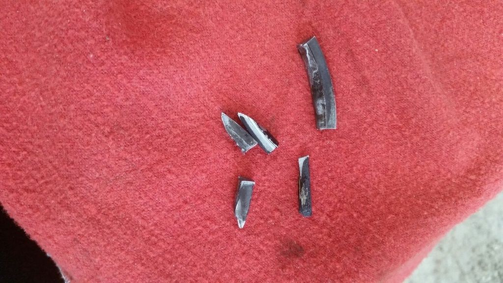

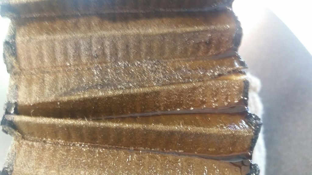

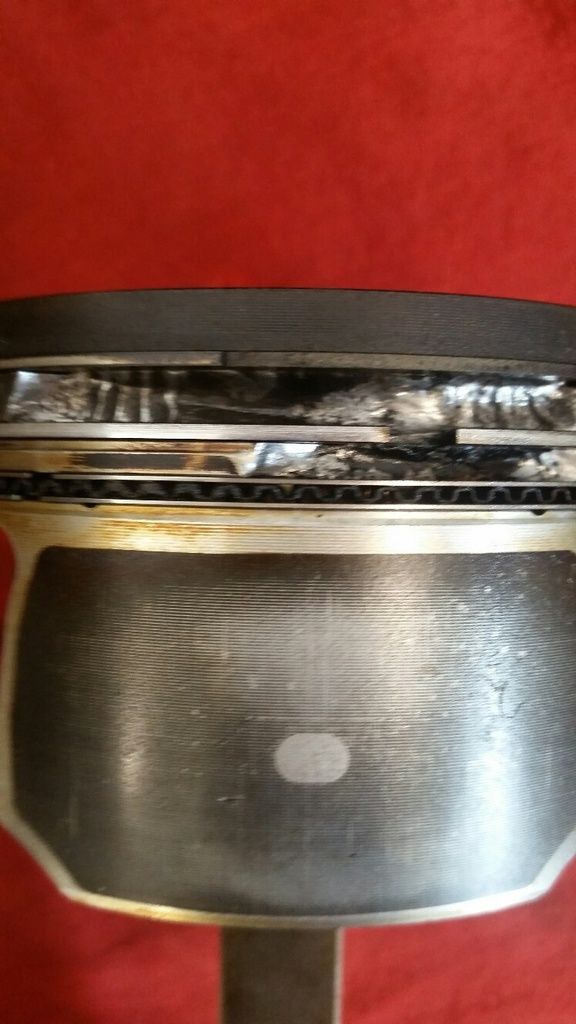

Now with pics!
Managed to get them to send over photos, didn't send a picture of the block, will ask her today if that is a possibility
Quote from: RagingPenguin on September 04, 2015, 10:49:13 AM
Now with pics!
Wow! Am I seeing right? Looks like that piston and ring set was self-destructing.

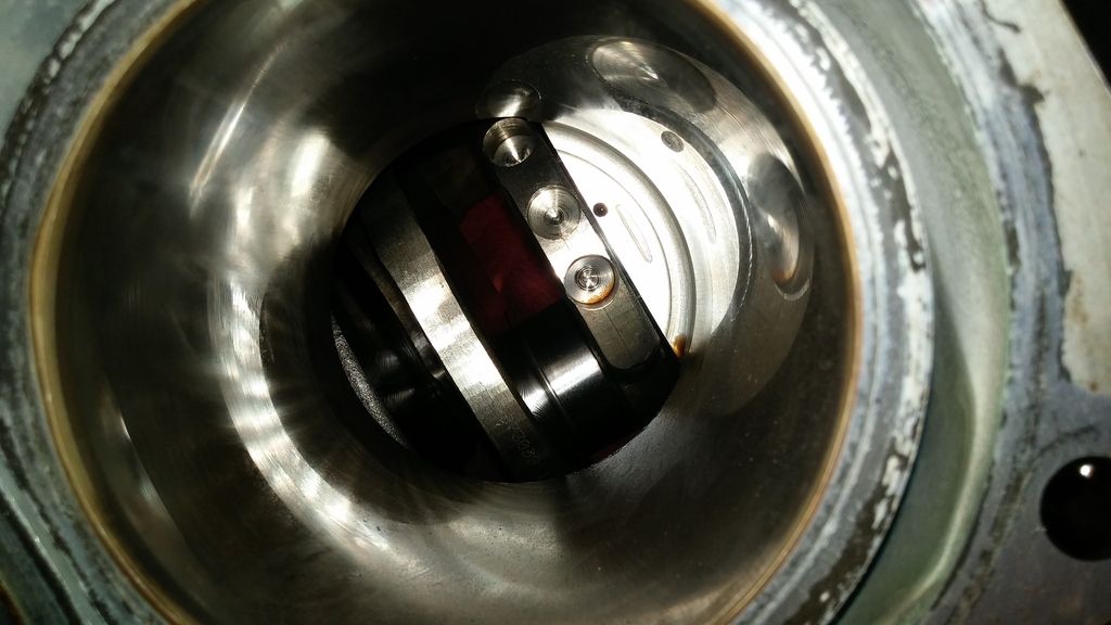

RagingPenguin
Cylinder. Not a nick in it.
Hoping that this indicates a happy out come for my cylinder heads!
That does look promising!
