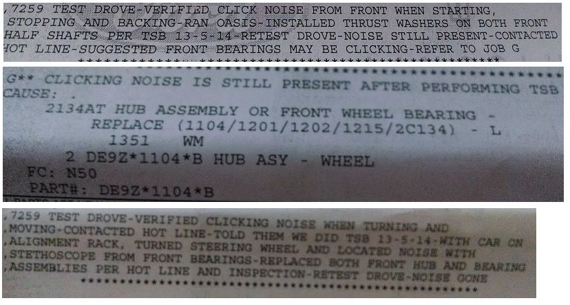

The dealer is working on a fix.  They are doing the washer TSB,  parts over nighted.  From the posts in this thread, sounds like the noise will continue and hubs will need to be replaced next.

Dealer called with an update.  Washer TSB did not solve noise, as we knew.  I pointed them to this thread and they ordered hubs.  Should get them tomorrow.  Get the Ram for another day, got a trip to the dump scheduled tomorrow morning! :)
Props to Phil Long in COS for keeping on the issue and getting this fixed for me.  More updates once I get them.
magnum: Do you have a 2013 Performance Package?  Seems to only affect cars with the PP.

Car is ready to be picked up.  Both hubs replaced.  I'll report back tonight after I drive her.

The tick/clicking noise is gone!  Glad to have my SHO back.
Here are the notes on the paperwork to help those who need this fixed as well:
