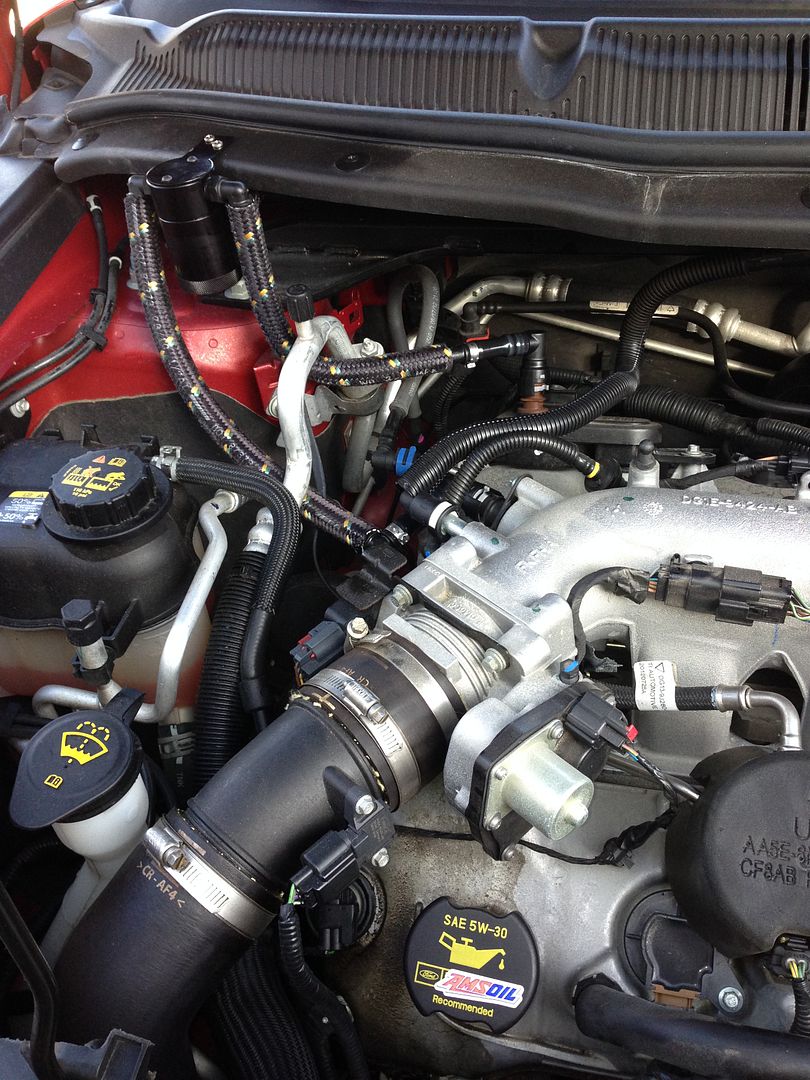

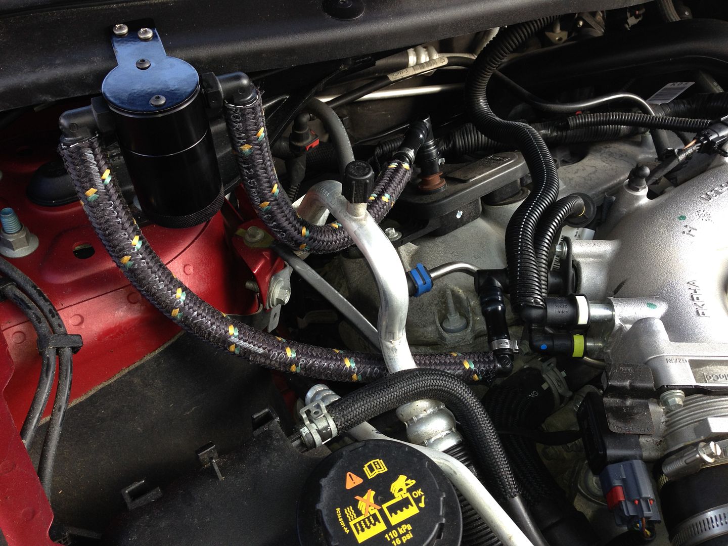

Ok  installed mine Install  was a piece of cake
Not sure if the lines were supposed to come with, but being in the AMSOIL biz, I had some laying around from a Bypass Filter set up.
As far as the plastic cover rubbing, I just trimmed the end a little  to allow it to clear the hose.
Nice setup!  Looking forward to your results :)

I would say the catch can works...
I cleaned it  15 days  ago
about 10 ml of oil
