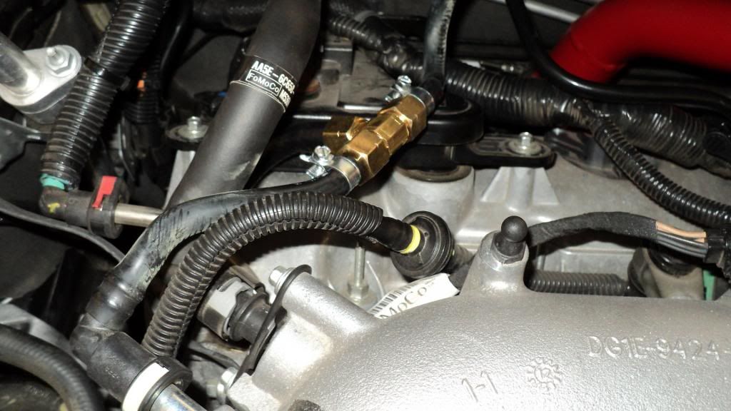

OK; huge thanks to crash for helping me out today on the phone.
It turns out the 2013 has a much different brake booster line than the 2010-2012 (possibly, we know for fact on crash SHO it's much different.)
So if anyone saw his photos in the thread about where to tap into for boost and vacuum; it's the same except you will need 1/4" hose clamps.
20 minute job ended up 2 hours; thank god I was smart enough to do this in the back lot at Home Depot--had to make several trips to get different fittings. Autometer has this wear adapter thing so instead of using a 1/8" barb, I needed a 1/4" barb to secure my boost line.
Thanks be to Crash & geswek!  BTW, that lens is fantastic!

I did the same thing on my 13 as vacuum source for the Tial BOV on my HotPipe Kit .
I wonder if it'll be OK to T into that Brake Booster  line further upstream closer to the booster itself for a secondary source  . I know you told me a few days ago your doing the Hotpipes as well but hadn't decided if your gonna do OEM or Tial BOV .
I still haven't installed my center pod from Crash yet for the boost Guage , coolant and tranny temps either .
Pondering on the secondary source though .
By the way I used 3/8 inner diameter braided fuel line to Tial and the barbs at all three points are 3/8 O.D.
Its kinda buried in the install info for the HotPipe kit.

Yep; you did what I did; same thing with 3/8 barbs; I just had to use hose clamps to hold them where as Crash was able to just slide his rubber hoses onto it.
We have different hoses from the older SHO it appears; guess they upgraded our hoses. :)
I will probably go with TIAL due to the desire to put bigger turbos in. I don't see why we can T into brake booster again. The only thing Crash told me was that if for some reason I got vacuum leak my brakes would go soft; but I think that's period--if we had vacuum leak anywhere it would affect all systems.

OK; so yesterday I spent 2 hours at Home Depot with crash on the phone fixing my boost gauge as said previously.
On the way home from grocery store I played around a bit. The boost is spot on now; 13lbs consistent with some 15lb peaks unlike the 20lb peaks I was seeing due to being tied into the wrong tube.
