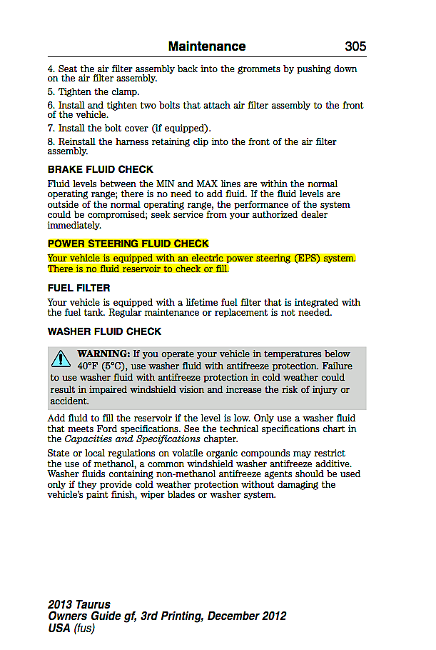

Quote from: SwampRat on March 12, 2014, 08:00:27 PMQuote from: SHO n GO on March 12, 2014, 07:56:03 PMAlrighty guys i have a 2013 taurus SHO, i was backing into my driveway today with fresh snow on the ground and noticed a line up the middle of my drive of green good sized drips. What fluid can this be? First thing i thought was coolant yes i know but the coolant in my car is orange. Just wanted to see what answers you guys have before i climb under there and check. I snapped a picture. Crappy cell phone pic but that is a bright green like coolant colored. Electric Power steering fluid leak .
