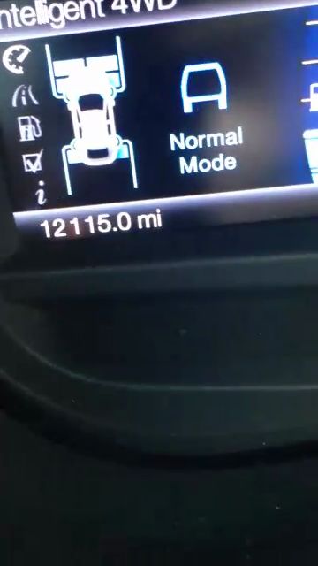

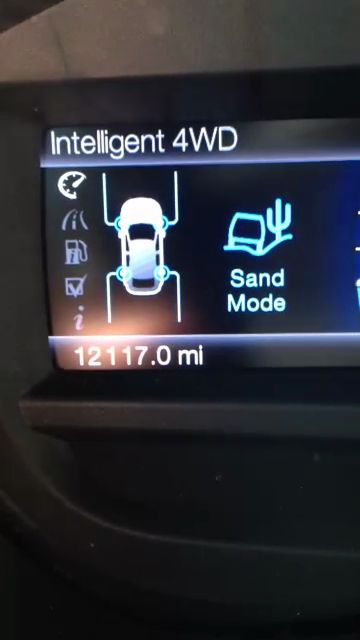

adamantium
2013 Explorer Sport. Stock for now.
adamantium

Hmmm, can't see the pics on my phone or laptop.
Quote from:
And what vehicle is that on?
/quote]
I wondered that and where to read about it on the same movies/posts found here: http://www.ecoboostperformanceforum.com/index.php?topic=1968.msg33547#msg33547
Gets very confusing to an old man like me
Quote from: FoMoCoSHO on March 15, 2014, 12:12:49 AM
They are movies linked from Photobucket... may take a minute to appear and a while to buffer... not quite as fast there for movies... here's direct links from the Photobucket account:
Normal mode: http://s16.photobucket.com/user/auditrance/media/E8C5881D-3E7C-47B8-804F-DF0CCE24D28B.mp4.html
Sand Mode: http://s16.photobucket.com/user/auditrance/media/05B999E4-D791-498E-9331-15CE60C6DA57.mp4.html
adamantium
Sorry gents if it didn't work. Photobucket is a pain sometimes. Thanks BiGMaC for organizing it better. It's a menu option on the X sport. Shows where the power is being transferred. If you notice normal mode more power to the front. Sand mode little more equal front and rear. Just giving a visual for those who try to activate the feature.
