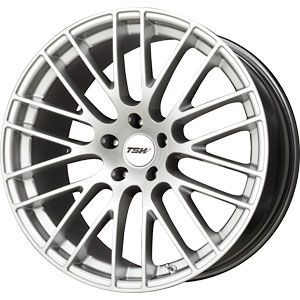

Eyeballing a set of TSWs, called Max.
Dimensions are 20X9 5-114.3 30
Looking for opinions on fitment and if it'd be a good choice.
I haven't paid close attention, but I assume a +30et offset on a 9" wide wheel won't cause any fitment issues. Not sure if a fender roll would be necessary. Just plan to swap over the factory summer tires for now. Still tons of life on them. Anybody know for sure about fitment?
While the flower wheels have grown on me overall, really think a good set of bright mesh wheels would set a Tuxedo Black SHO off nicely.
Here's a photo...

In case this helps:  bpd Mike has used 20x8.5 TSW Nurburgring with a 40mm offset in front, and First-SHO Mike has used Forgestar F14's 20 x 9.5 with 36mm offset in front.
Lanson
Wheel is on the heavier side of TSW's offerings, and 20" sporty wheels in general.  Someone pegged 29.4 lbs for the 20x9.
The +30 offset on a 20x9 means the wheel should be a great fit in back, but may poke a bit in front.  Your call if that matters to you.
