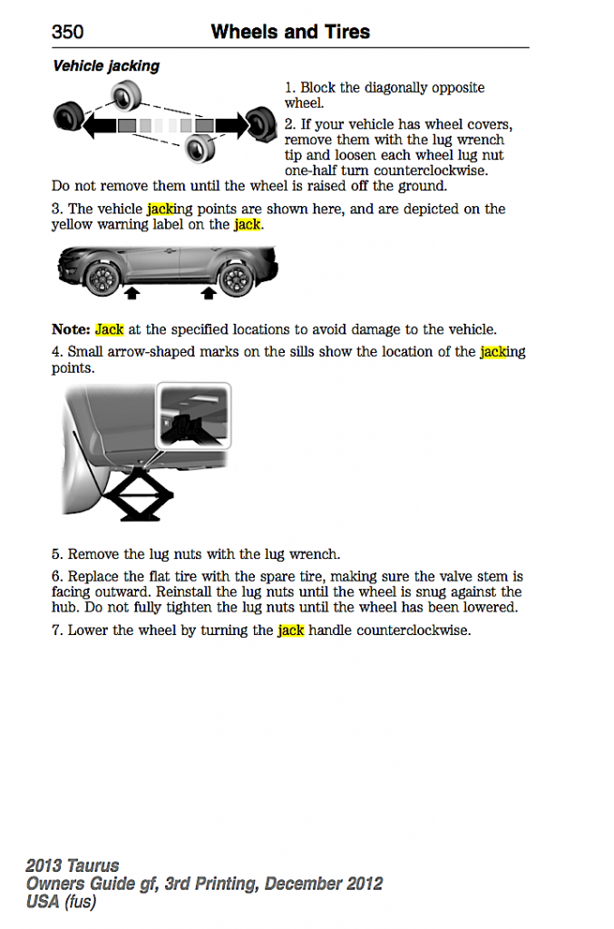

Does anybody know where the jack points are on the 2013 SHO? I'm pretty sure I see where they are in the rear but didn't really see in the front-tks!

If you look closely under the car, you'll see cut outs in the skirts with an arrow indicating the locations.

Here's the manual...
left click the image to enlarge

Very helpful-thanks!
