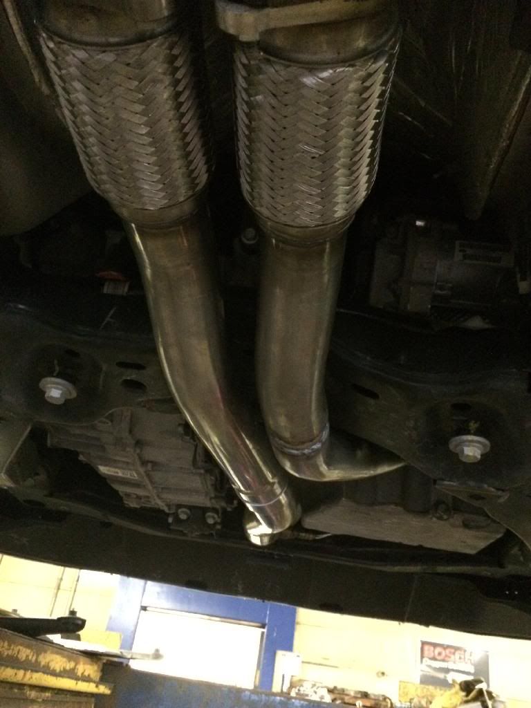

My LMS down pipes came Thursday. Finally have time to get them put on today. Updates coming soon. Excited!!

Noticeable difference in the size of these pipes. Wow

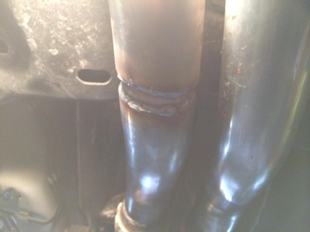

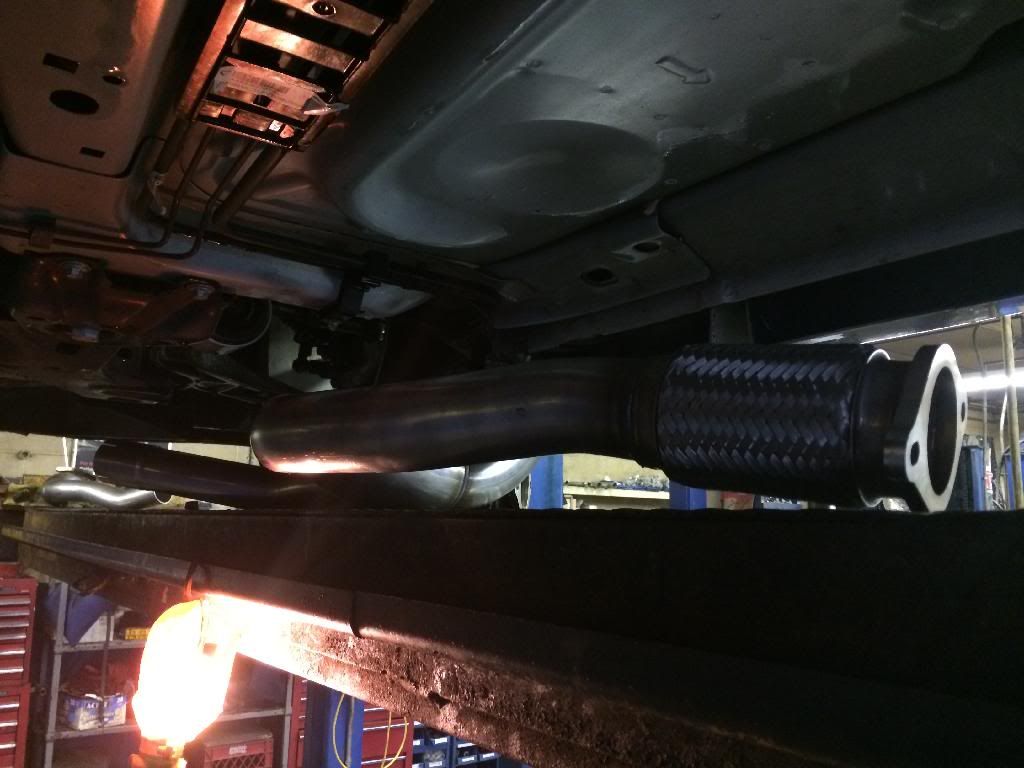

Everything is in. It's a thing of beauty. After a test drive, it's clear the turbos are spooling faster and there is more power down low. Noticeable difference. I noticed a gassy smell. But they may be break in. Nothing to be worried about. Also had a small fitment issue that they were able to clear up by adding a small piece. Happy with the product. LMS does it again

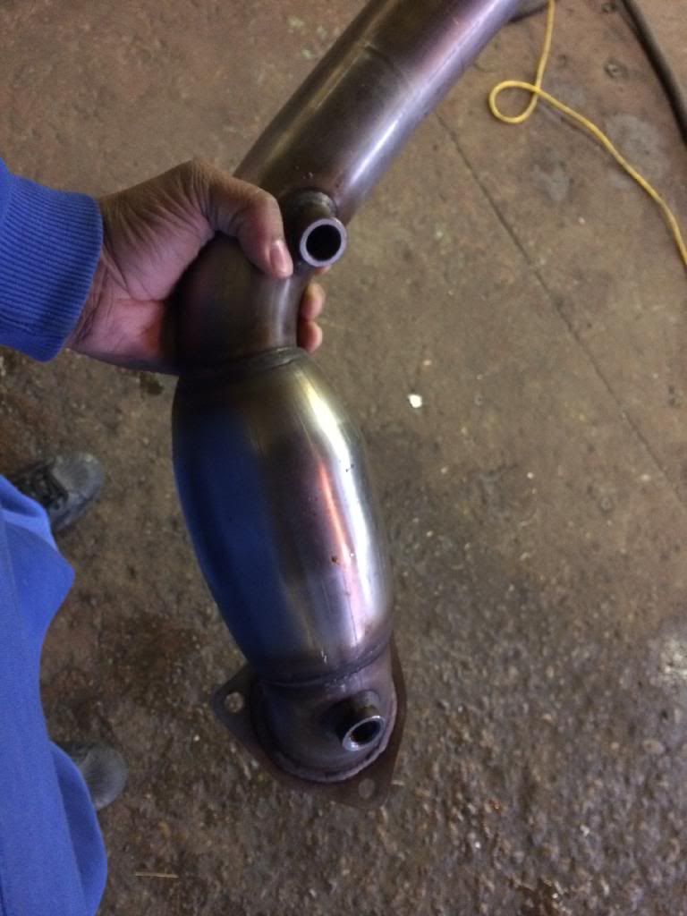

QuickSilver
Sexy :thumbsup: Are those cats or a perforated core resonator?

That's the flex pipe. The cats( I got the catted system) are right behind the turbos.
