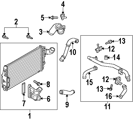

Let me know if I understand correctly:
The item #4 in this picture is a 3 bar MAP sensor that my SHO came with

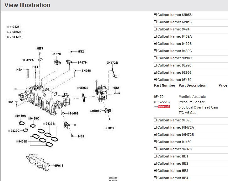

And the item #9F479 in the next picture is originally a 2 bar MAP that I need to swap with the 3 bar I just purchased

Yes Pelo.  You are swapping out the sensor on top center of the intake manifold.
