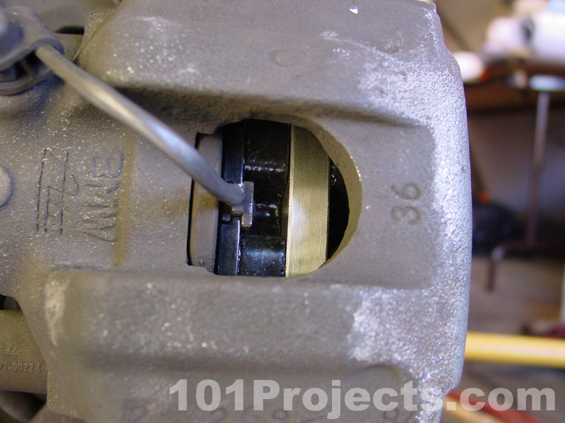

My 2001 Bmw has brake pad sensors as SHOdded mentioned,very effective in letting you know when its time to change them and prevent costly repairs,the only issue is wiring the sytem and being able to connect it to the ECU and then it can alert you.http://www.101projects.com/BMW/Projects/051/images/DSC03750.JPG  hopefully they will update the needed sensors.
