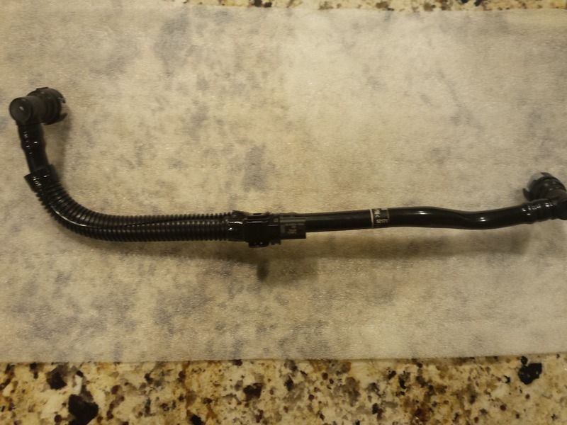

Guys, sorry to resurect an old thread, but I am installing the can on my 16 and hit a bit of a wrinkle.  My pcv pipe from the front port that will get capped to the intake pipe has a sensor on it. This sensor is going to be removed with the pipe upon ccs install. The sensor was not mentioned in any install wrietups and I have no idea what its for.  Can someone shed some light on it. I can not imagine I can simply leave it out. Thanks

Here is the photo of the pipe.  It is what will become the CCS side line...more or less.  The sensor in question is in the middle of the pipe.

Any idea what the sensor is for?  Other do not seem to have it.  Is this something Ford added for the 16 models?
#95
Here's the link from Ford but in my opinion its an EGR Sensor,also RX only shows diagrams from 11-14 Ecoboost.  Z          http://www.rxspeedworks.com/wp-content/uploads/2014/12/Ford-EcoBoost.pdf

I think i found that bad boy,its a EGR Pressure feedback sensor,you can also click  in the diagram for more results.  Z        http://www.fordparts.com/Commerce/PartDetail.aspx?n=wJ5rw4UYbmUXFHplRQm%2fiQ%3d%3d&id=341340225&m=2&search=true&year=2016&make=Ford&model=Explorer       Update on Rx 11-14 Install only Instructions.    http://www.rxspeedworks.com/wp-content/uploads/2014/12/Ford-EcoBoost.pdf

Yup, that's it.... The EGR sensor only appears on the 15 and up models.
Called RX.....Apparently you don't need to drill into the factory turbo pipes anymore.  But since I have already done that I focused on what I need to do with what I already have.  Apparently, that pipe with the sensor can and should be left alone.  No capping of the port.
Some advise for these that are doing the installation for 15 and up models:  call RX for direction.  Don't follow instructions in this thread or even these on RX's own web site.  They are not completely accurate for the newer models.
